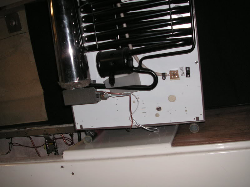

The pictures of how I built a gas powered fridge into my Ansfold:
1. Shows fridge snug beneath folded LH side.

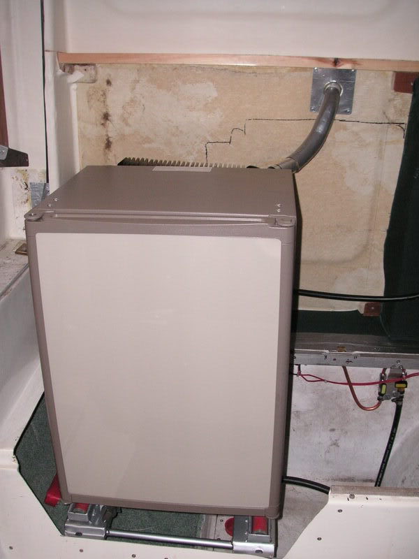

2. Fridge stowed, van erected.

4. The fridge sits in its stowage at a considerable angle, the better to align with the folded LH side which clamps fridge against movement when travelling.
5. View from n/s/r corner of caravan, looking forwards & inboard, showing extra depth required in fridge-locker of 1 1/8".
6. Fridge-locker, looking towards n/s/r corner. The 2 red bungs are for water input (pump) & waste, being larger than their pipes they allow extra air in under fridge when it's running. The top face of the lockers, which has had to be cut back, is stiffened with 1" x 1" x 3/16" aluminium angle. This also gives added support to the side-panel hinges, & carries a convenient bracket for the gas-taps.
7. Back of the fridge. Shows base which is at an angle to the casing, necessary to reduce overall height towards the rear of the van, when stowed.
8. Left-hand side of the fridge. This angle reduces height required at the outside of the locker, to prevent the need to lower the whole of the locker floor. The 2 angles together "translate" to the fridge top face sitting snugly under the folded side at exactly the correct angle, so folding the 'van down clamps the fridge in its locker, as seen in picture 1. In use the fridge stands exactly vertical, of course; the weird base-angles are cancelled by corresponding angles to the mounting-base shown in picture 9.
