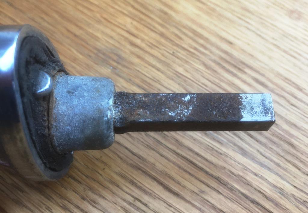

If you have an old original rusty Portafold handle like this:
And the shaft looks like this:
Rub it down with some wire wool or a wire brush, till it looks like this. The number is 944, so that means the key number is FS944.
