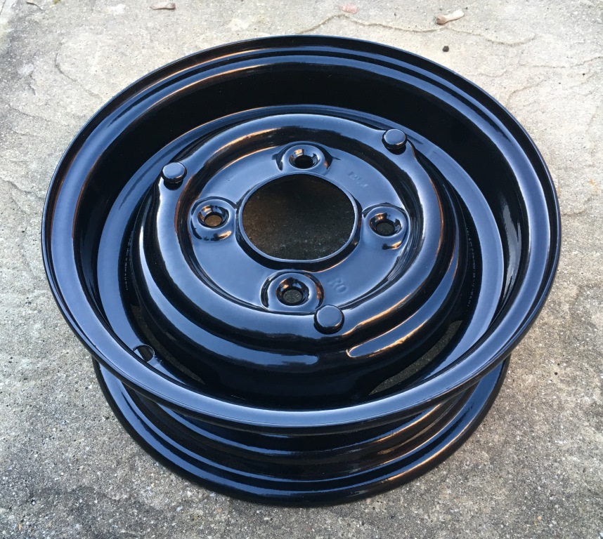

Only just noticed the last bit - I will indeed check my nipples before purchasing!petman wrote:mines fitted with standard mini chrome trims as described above, but they have a space for the valve as standard
had a look on ebay and found some
make sure your wheels have the hubcap "nipples" before buying
Nipples?
Interesting point about nipples, Petman, I hadn't seen it either till Knotty emphasised it! All the Mini wheels I've ever seen have had the pressed-in "bumps" in the hubcap rim. So the hubcap slides over the rim itself. The nipples to which you allude must be on some trailer rims, I'd guess, rather than actual Mini ones. So my immediate thought is, turn up some nipples on the lathe, with threaded ends perhaps, then drill & tap the bumps on the Mini rims to accept them. By doing this one could space the 'caps out to any suitable distance, or, by altering the diameter of the ring of nipples, fit any convenient hubcap, within reason! I wonder why I didn't think of that....never mind.
I wonder if I could persuade the Mini rims to accept the same hubcaps as my Morris! That'd be really good! Seriously though, if it works it'd be a good answer to the Ansfold hubcap problem. In that case I'd be happy to make nipple-sets for others if anyone's interested.
By the way, Knotty, I saw you got those Mini Cooper ones, well done. I didn't bid against you. Would you measure the depth of them, please, & let us know?
Wheel nipples
Thanks for the pic, Petman, seems I have a genius for misunderstanding! That's the standard Mini rim, as of course you know. I thought you meant the locators often found on 1950s pressed-steel wheels. These were riveted or welded to the wheel after it was pressed as manufacturing processes were less developed then & it wasn't possible to do hubcap bumps as part of the press process. (Sorry I don't know how to put a picture link on here).
I presume your original point was - modern rims don't have hubcaps, so no bumps?
