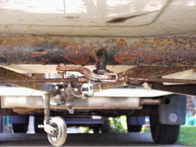

Since purchasing the Portafold late last year my brother has only done a few jobs first was to free off the seized overrun coupling, constant applications of plus gas and a copper mallet eventually freed it. Initial inspection looks like it is saveable but I will have to strip it down later. While we at it I freed of the brake compensator to stop the brakes rubbing which makes it easier to push around. As I was underneath I noticed one of the wheels sitting further away form the axle than the other, as they where both the same later mini wheels I whipped them off for a further look and found my answer, one side had been fitted with not the best wheel spacers I’ve seen!

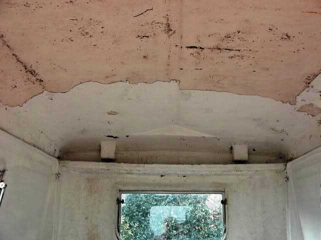

Not much involvement over the winter while my brother removed the bitumen paint from the inside of the roof and some fibreglass repairs.

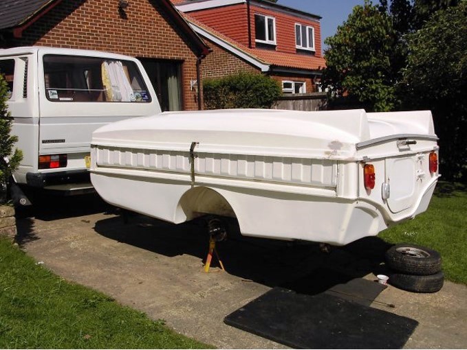

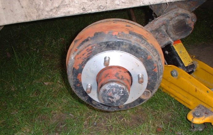

Some nice spring sunshine. Time to get it up on axle stands and check over the running gear.
First job to clean up and lubricate the brake compensator so I can check the operation of the brake shoes later.

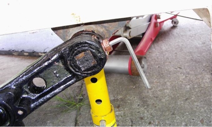

After a few overnight soaks with Plus Gas of the trailing arm grub screws, removal of the arms for inspection and regreasing
Oh dear I didn’t want to see this. Virtually devoid of grease and the arm had picked up parts of the plastic bush. Really the axle should have a couple of grease nipples for easier lubrication.
After a good clean up and refitting to check for any play, the arms and bush appear to have survived the lack of lubrication.
At least the springs where in good condition but a surprising amount of machine swarf stuck to them.
One tip with dealing with the grub screws especially if you have to use a lot of force to shift corroded screws is to clean out the Allen key hole properly; the key fits in quite a long way up to the mark on the key and use a key of good quality chrome vanadium steel.
Also leave the lock nut at the top of the screw to stop the Allen key spreading the screw and rounding out.

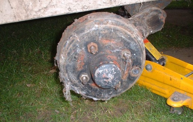

The brakes where in good condition, just requiring lubrication of the pivot points and new expander boots.

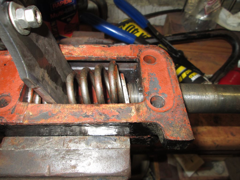

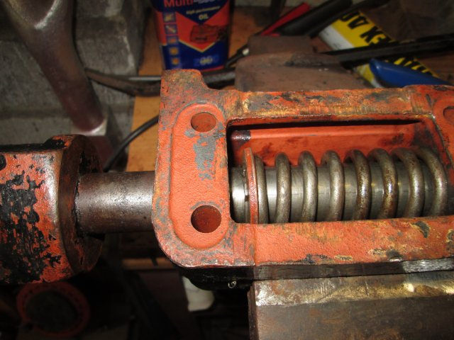

After freeing off with a copper mallet and plenty off Plus Gas there was no spring resistance.

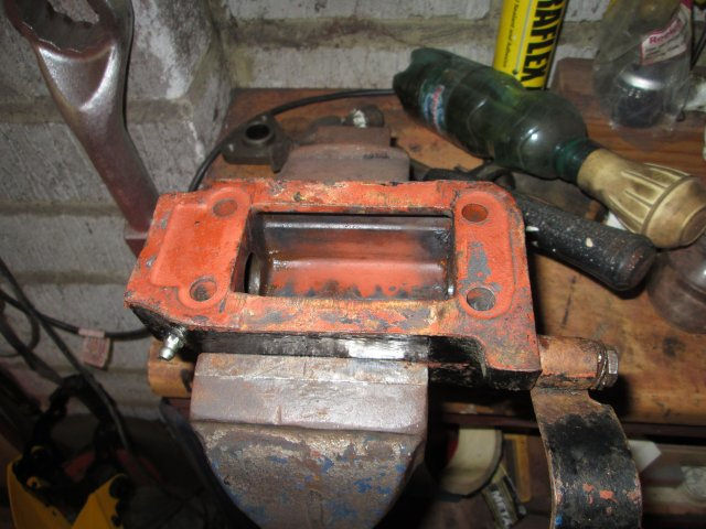

So to strip it down and clean out all the hardened grease.

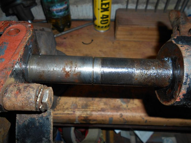

To find the circlip that fits in this slot which pushes the spring had broken.
Not an easy job getting a new one in, obviously Bradley had a purpose designed spring compressor. I had to resort to a brake caliper piston push back tool.
Circlip in place and the end nut tightened. Finally the internals where sprayed with water repellent spray grease to help stop corrosion and a couple of new grease nipples fitted.

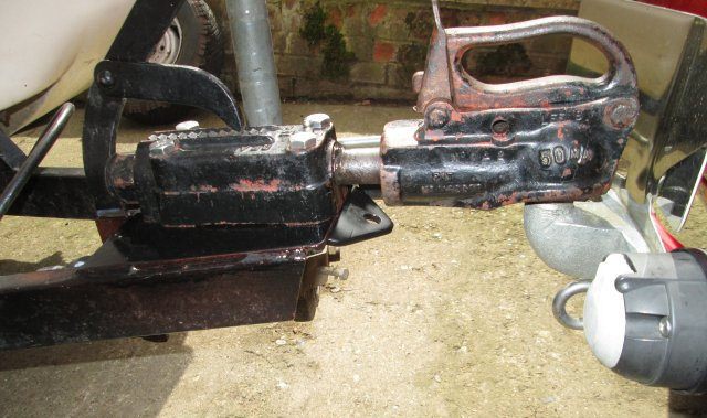

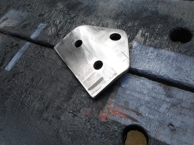

While I was at it made a bracket that is held by the hitch bolts to anchor the breakaway cable.
Finally refitted ready for a test tow. I used new M10 bolts with nyloc nuts in place of the old imperial bolts
