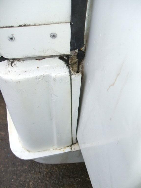

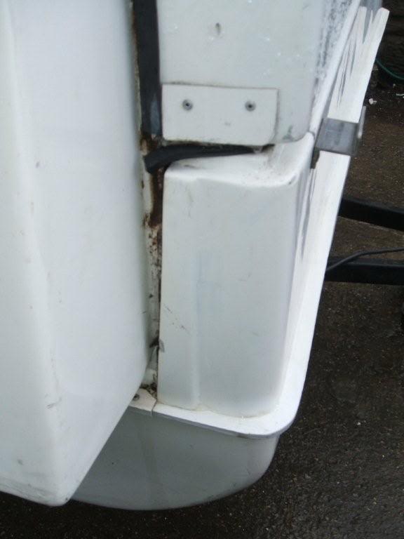

Malc has asked for some help.
Spot the difference between the two pictures below...
and if you can, does anyone know where to get the trim from?

Hi, these trims can easily be fabricated, I used 18swg soft aluminium sheet for mine, I needed 2 for my Ansfold.
Cut the metal to length & about 2" wider than the widest part of the development.
Bend the first fold in the vice, holding the centre part between one vice jaw & a piece of hardwood or metal the same width or narrower than the inside width of the channel. Leave plenty of 'flange' to finish to size after making the folds.
Turn the part-folded blank over, so the next fold is level with the top of the vice & the inside of the channel is again held between vice-jaw & metal (or wooden) block. The block has to be wider than the first flange, else the spine of the part can't be trapped correctly.
Make the second fold.
Cut both flanges to the correct widths & tapers to fit your 'van with minimum clearances but without filing. I recommend hacksawing first, then finish-filing to size.
Hacksaw & file the shaped top.
Erect the 'van, leaving the side panel folded fully down to gain access, then mark accessible positions for drilled holes. Where these finish up depends on the size of drill-chuck you have, how far down you can fold the 'van side, previous damage etc. Drill the holes in the new baffles, then hold each in place & drill the 'van hull. I attached mine using self-tapping screws rather than rivets owing to the difficult access.
If you used aluminium, it must be etch-primed (e.g. 'Acid 8' available from Halfords) before top coating.
Clean the hull & fit with a little bathroom sealer or similar behind them, as much to prevent their working loose than for reasons of actual sealing.

Hi Bigbird,
This 'trim' part is one that Portafold would have made for themselves, rather than buying it in from an outside supplier. Fortunately, it's very easy to make at home out of aluminium sheet, provided you have some wood and a bench vice.
