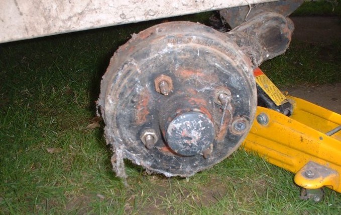

Since purchasing the Portafold late last year my brother has only done a few jobs first was to free off the seized overrun coupling, constant applications of plus gas and a copper mallet eventually freed it. Initial inspection looks like it is saveable but I will have to strip it down later. While we at it I freed of the brake compensator to stop the brakes rubbing which makes it easier to push around. As I was underneath I noticed one of the wheels sitting further away form the axle than the other, as they where both the same later mini wheels I whipped them off for a further look and found my answer, one side had been fitted with not the best wheel spacers I’ve seen!

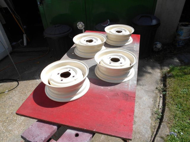

Wheels have been shot blasted and painted with light ivory paint, three for the porta and one in reserve. Just waiting for the paint to harden off.
