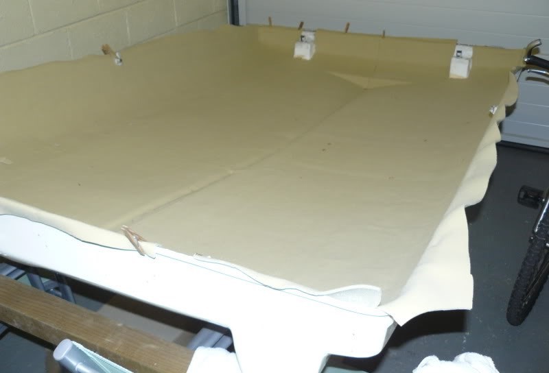

Fitting the headlining.
Headlining finished 1.
Headlining finished 2.

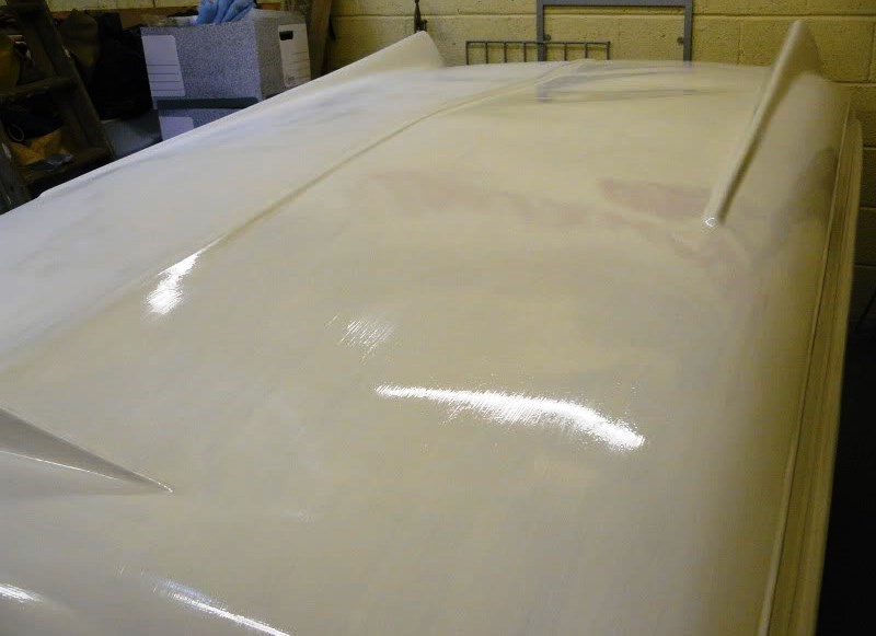

Portafold roof rubbed down ready for painting.
Portafold roof painted with second coat.

Hi Fraser,
What a superb job you've made of it! I'm particularly impressed with your roof-lining on the mesh fillets over the fin-hollows.........how many fabric sections are there to the main area? What material & adhesive did you use? Also, are the walls painted or trimmed in material also?

Hello Steve,
Thanks for your kind comments, it has been a long hard slog to finish but worth it I think.
There are two sections to the roof with a join in the middle which we hid with some binding tape. I can get the details of the company we got the material from if you wish, I think the total cost was around £70 including six cans of upholstery adhesive. Basically we stuck it down with that and it appears to have worked well, we have stayed in it for five nights and had no problems with condensation. It seemed easier to glass over the fins rather than try to fold the material into them, if you want more detailed pictures of the finished article just let me know.

Hi Fraser,
You've done exceptionally well to get your roof so wrinkle-free with only 2 panels! Your material must be very pliable; when I attempted this on my Ansfold I either had severe wrinkling around the edges or, on the second side, the central area of the lining pulled away from the roof, due to too much stretch. Admitting defeat, I stripped & painted it instead.
I would be interested to know which adhesive you used & how you applied it. When this sort of thing is attempted in cars such as Jaguars (where the headlining-fabric is bonded to shaped hardboard-type panelling) it's difficult to get it to stay up, long-term.

Hello Steve,
The adhesive we used was TRIM-FIX ADHESIVE designed for high temperature conditions. There is no manufacturer name on the can so I don't know who makes it, if you want I will try and remember the company we got the headlining from and they might be able to help.
I can honestly say that it was very easy to cover the roof and only took my wife and I about three hours to complete the job. When the adhesive goes on it looks like the silly string that children play with but it dries quickly and appears to have very good adhesion properties, I would recommend it to other owners who are experiencing condensation problems. It is also an easier job as you can turn the roof over and press down hard on it with a small roller to get rid of any creases. The headlining if I remember correctly is 4mm foam backed and comes in four colours.
