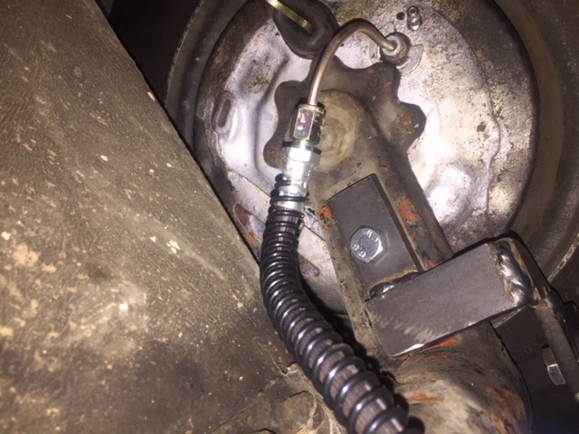

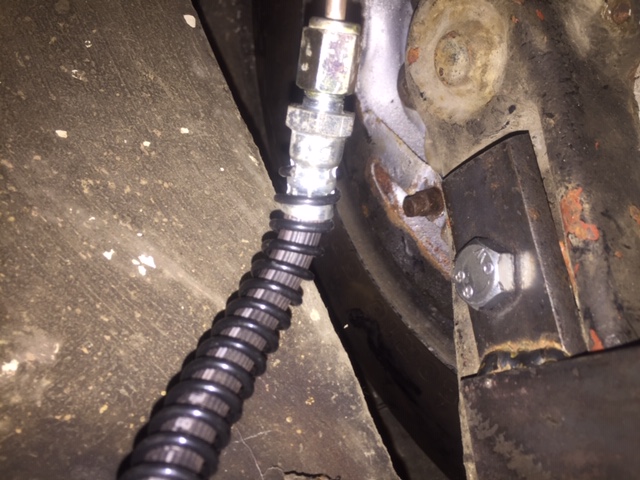

Having taken bigherbs point on board I’ve has a rethink ref the hand brake. They are upside down and the cables aren’t connected yet as I’m waiting for a second pulley. The 1” flat sits in the recess of the trailing arm and am M8 bolt secures it with a spacer in the original hole in the arm. I didn’t want to weld anything on the arm or axle so this looks like it will work. I’ll update when tested

Yep that's the idea. I would connect the cables now to the original compensator, saves a lot of extra work. You will also need a keeper around pulleys to stop the cables jumping off an L shaped bit of metal bolted to the pivot bolt would do.

Yes, that’s the plan. I’ve cut the cable and have drilled a 4mm hole through an m8 bolt which will act as a clevis on the original compensator.
Thanks. Probably wouldn’t have thought about it had you not have pointed it out.
