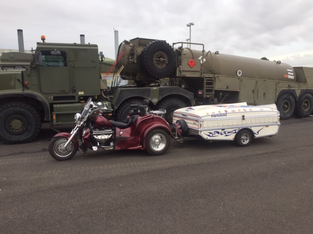

Hi all, I’m towing with my Trike and find the Portafold is pushing when breaking. The over ride brake is working but not when breaking because of the push. Has anyone ever fitted or know of anyone fitting hydraulic brakes drum or disc.

Thanks for the two reply’s so far ! I thought about a lighter spring but it’s getting on ? If a car locks up then the over run will kick in. Because the Portafold pushes the trike in hard breaking there never seems to be enough force on the over run.
I asked about hydraulic brakes because I saw a motorcycle towing a braked trailer. It used a quick release coupling to connect the trailer brake to the bikes rear brake system. The trailer braked when it bike braked assisting in the total breaking force. Very clever.

Just for an update I’m planning to fit mini drum brakes so watch this space

Well no in a word. The plan is to not have a master cylinder on the trailer but link the trailer brakes to the trike brakes. When the trike brakes are applied even a small amount the same will happen on the trailer. That will prevent the shunting in getting at the moment. The mini back plates were delivered yesterday so I’m hoping I can use mini back plates and the Portafold drums. Otherwise it will be a stub axle change. This is unknown territory so any suggestions greatly received
