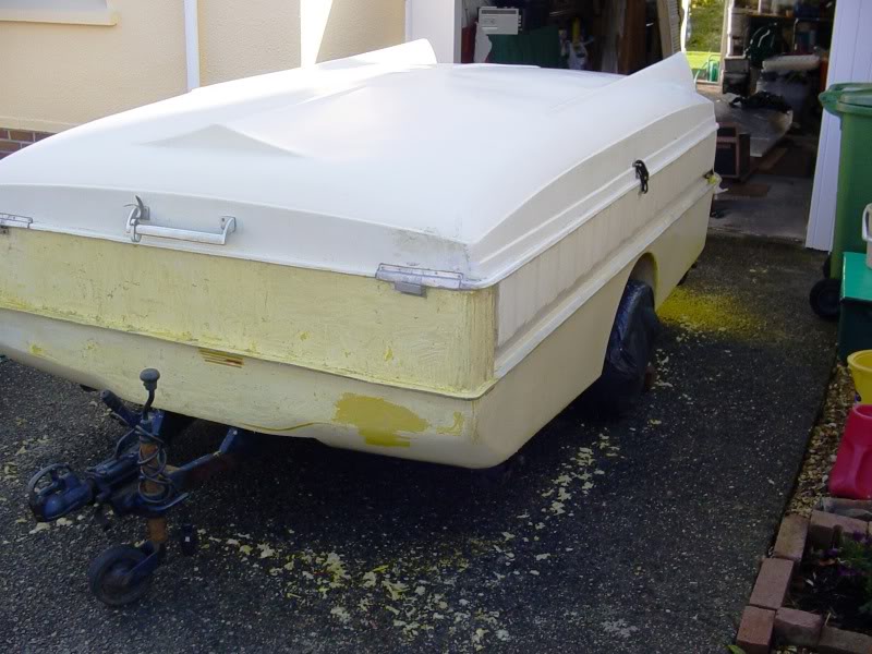

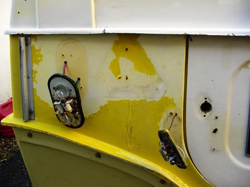

I've found the pictures I took when I stripped the Daytona yellow paint off the bottom part of my Portafold, Easter weekend 2006.
Since these were taken a lot of T-Cut and polish has been used to get it back to the original cream gel coat, but it was well worth it.
Nice and bright yellow, plastic bin liners over the wheels to protect them from the paint stripper.
You can see the bits that have been started on on the off-side front corner.
The yellow patch is actually a repair that they coloured yellow. Took a bit of scratching before I realised it wasn't stubborn paint!
That pin striping is hanging on for dear life.
That pin striping sticks really well!
