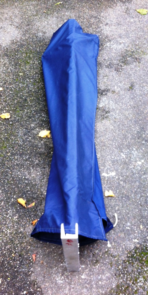

Lifting Winch
Post by shaun_pierce » Wed, 22 Nov 2017, 11:45 am
Saw one of these at a Portafold International some years ago and decided to get one made.
