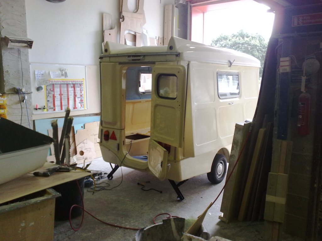

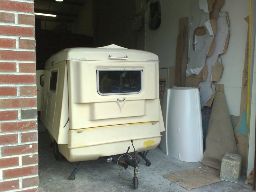

I had to cheat, I don't have the technical abilities of you guys so I popped it 5 minutes round the corner to a GRP specialist who's bread and butter work is making parts for Sunseeker luxury cruisers.
I stayed around to assist and to guide him in the 'way of the Portafold' and he changed four of the off-side hinges and two down the near-side. Those were the badly aligned hinges which had been bodged soon after I got it about 7 or 8 years ago. But that involved the digging out and the repairing of the inner skin of my side walls, which had cracked and separated from the rest of the wall.

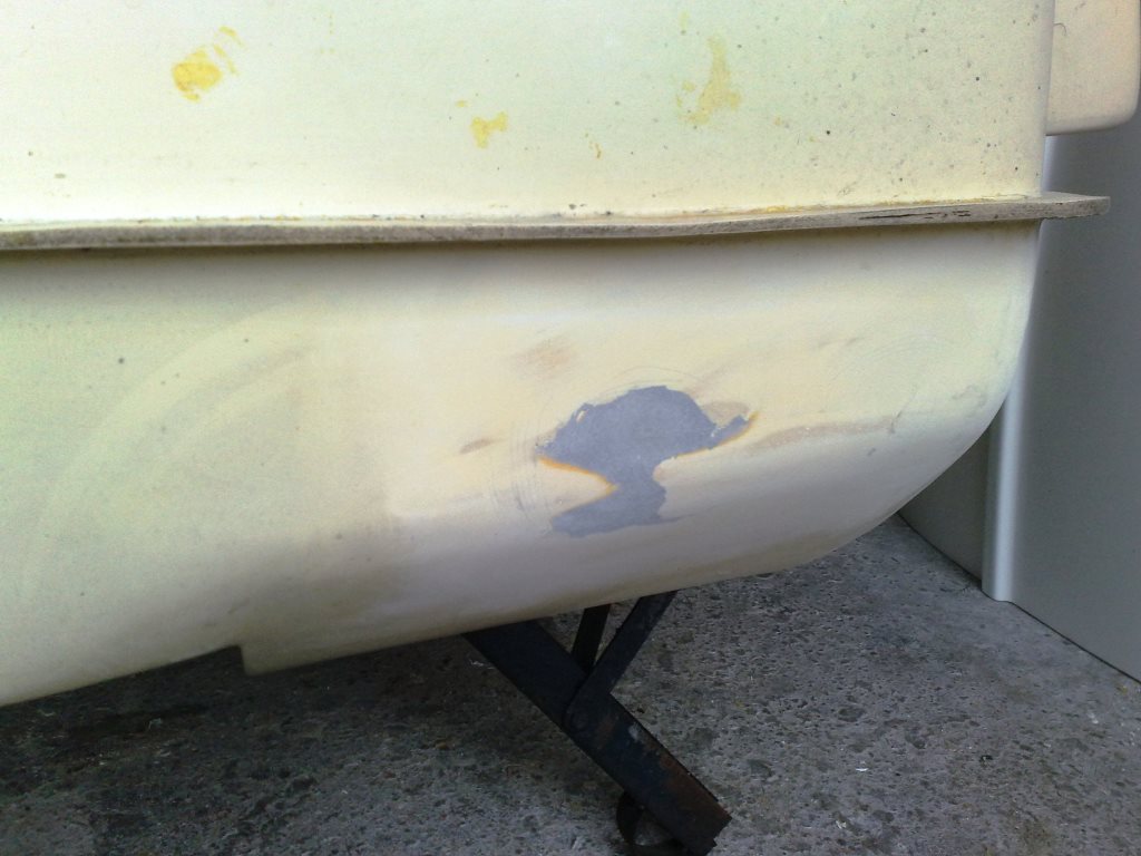

All ready for work to begin. Notice the yellow gellcoat filled jack-knife repair to the front.

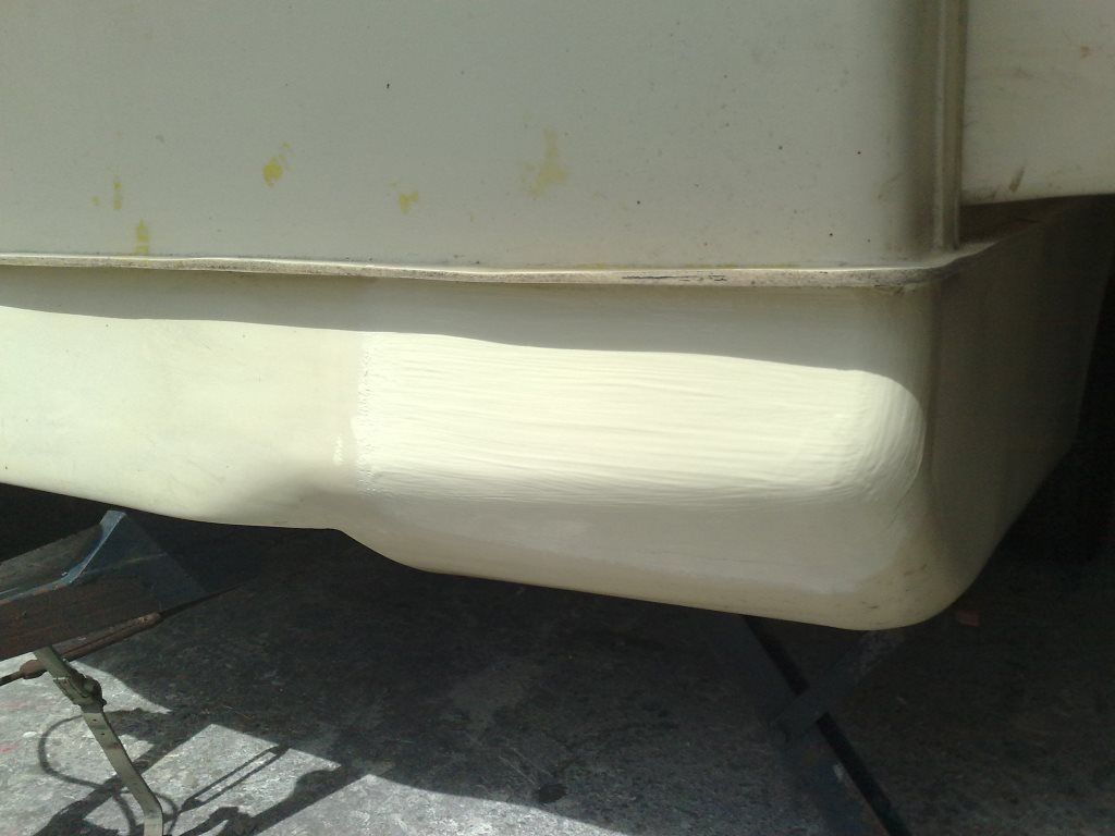

The repaired patch now sanded back ready for new gellcoat.
New gellcoat applied and drying off.

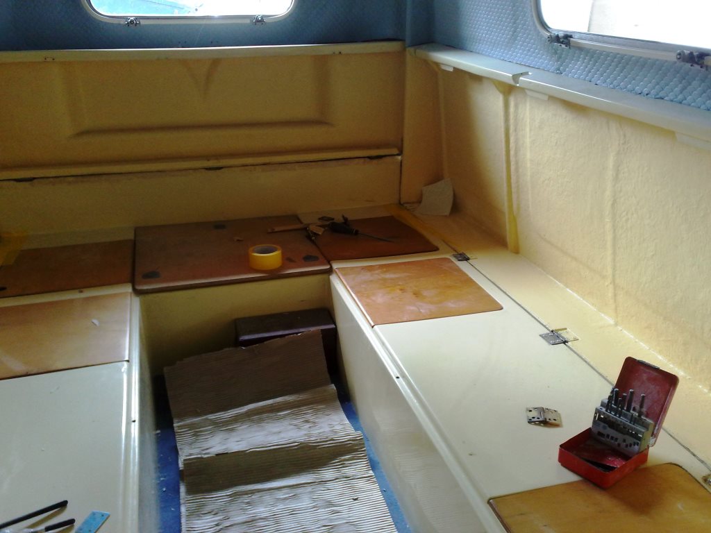

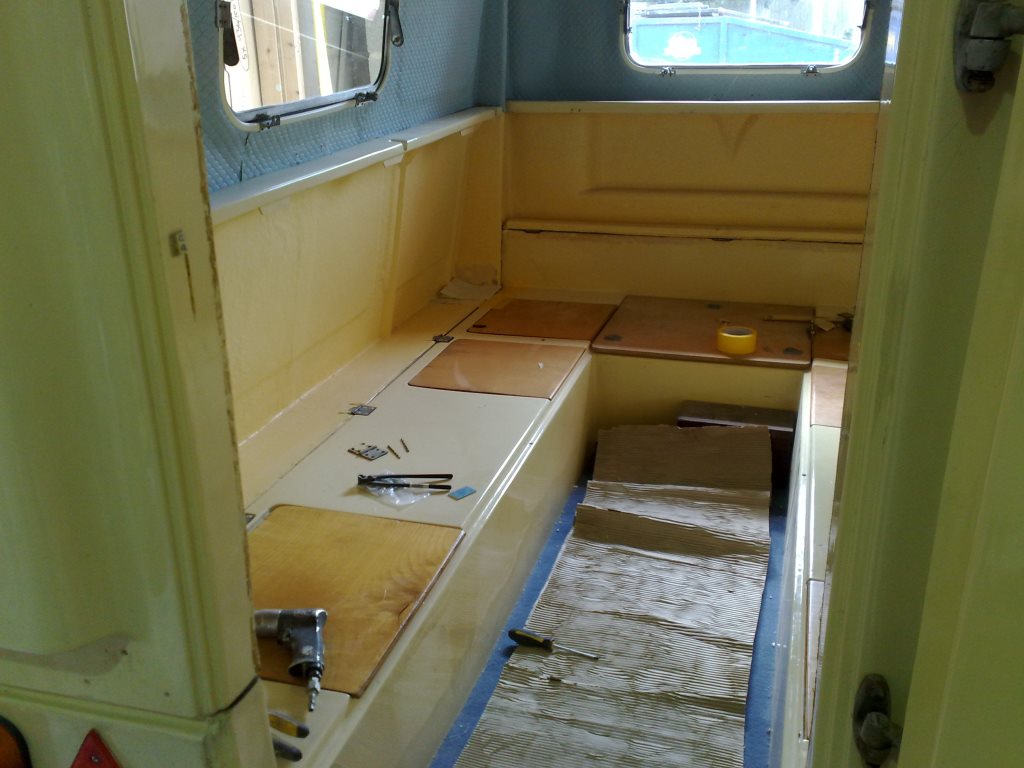

The hole left by removing the hinge and its old glassfibre repair.
Mock up of how the new hinge will sit.

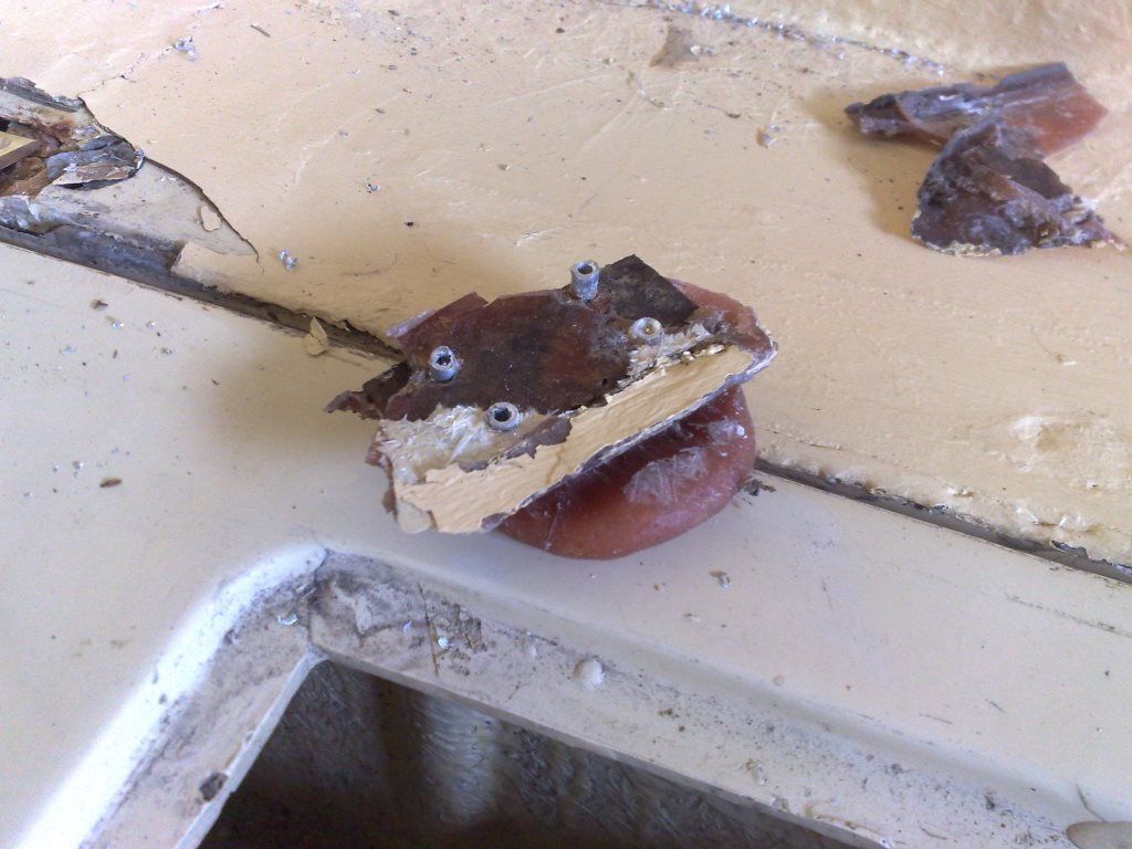

The original steel plate and blob of gell behind the old hinge.
After the area has been ground back ready for new glass.

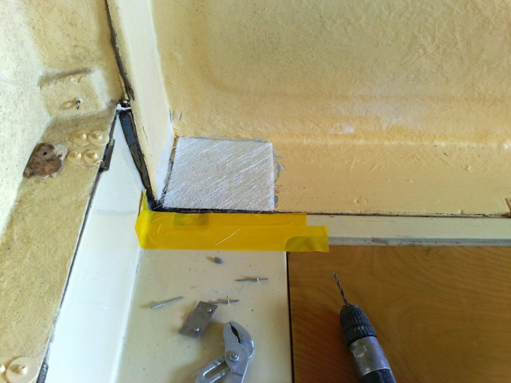

Areas masked up and new fibre cut to size

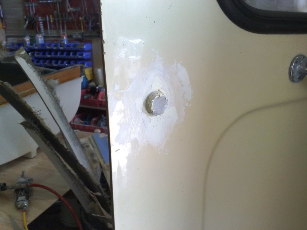

Plasticine plug stops the door handle hole becoming too small when it's repaired. The screw holes were so worn that my handle kept falling off.

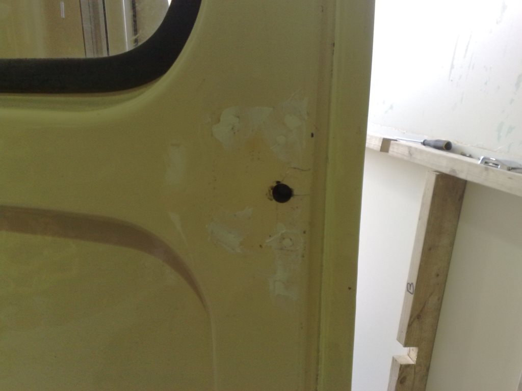

Inside holes also filled as these four screws have to take the full weight of the end wall when you put it up. I only had two!
