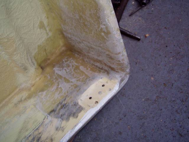

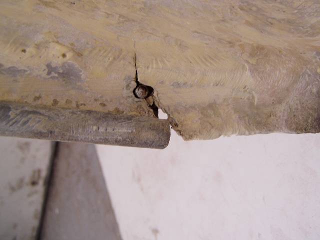

Then to look at the hinge panel at the bottom. Due to a couple of reasons the two skins of this assembly had parted company.
Also at the end lower corners the fibreglass was breaking up.
The reasons for all this, a combination of partially seized hinges, not very good bonding along the edge and laminate being laid on gel coat finish with out keying first.
The end parts were cut away to uncover good fibreglass.
The top and bottom skins of the lower assembly were held apart and a generous amount of Sikaflex was injected in between, then the two skins taped together to “go off”.
After keying with a course sandpaper the end corners were laminated.
Then trimmed and sanded ready for a coat of “top coat”. The tape was removed from the Sikaflexed joint and also sanded.

Into this ………….
With the resulting roof interior looking like this …………
There are some repairs to be made ……….
The worst of which is a “sag” in the fibre glass on the right side at the rear. Not that obvious in this picture
But we need to sus out what will have to be done to make it stable before we go any further.
I’m off to work on a plan, so see you next time.
