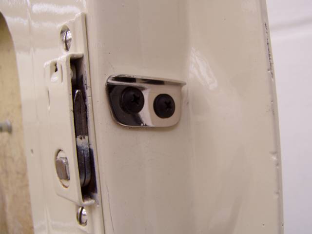

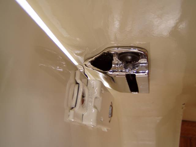

Whilst waiting for the paint to “go off”, ‘cos I hate watching paint dry, I finished off the lower door catch.
We had been having problems with the lower door not closing level. This was to do with the position of the hinges, having not been fitted correctly at the factory. Although these are self aligning hinges, they have to be fitted with the axis vertical for them to work properly. Inside the body is a strip of metal that is drilled and tapped with a thread to take the securing bolts for the hinges. It wasn’t possible to retap the threads further down, by the small amount needed, so I made up a new striker plate to fit on the door “frame” and a wedge device to fit on the door. As the door is closed the final amount, the wedge contacts the striker and lifts the door into its proper position. The items were fabricated from stainless steel and polished. Just need to substitute the black screws with some stainless ones now.

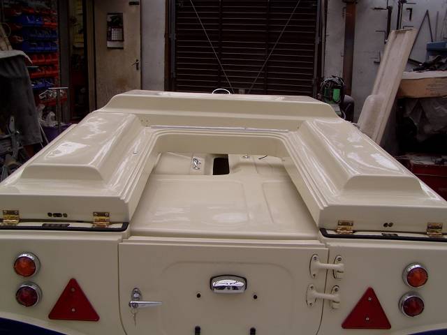

So with the right hand side riveted on, it’s now time to turn attention to front and rear walls and the upper door.
The upper door did require some considerable repair work. All the “damage” probably happened, either when it was pulled from its mould or when the inner and outer skins were clamped and laminated together. All the cracks were ground out to below the gelcoat and filled with resin and chopped strand mat. This was then sanded and filled with normal body filler to get a smooth finish.
The ends really didn’t need too much attention, so together with the upper door were sanded and primed. A quick guide coat and left overnight. The following day all the panels were sanded and sprayed with three coats of “Old English White”.
Once the paint was dry, the hinges were added to the ends. The following day the flat seals were added to the main body, at the ends, and the ends then fixed to the main body using stainless steel screws (they don’t rust like the old ones!!).
