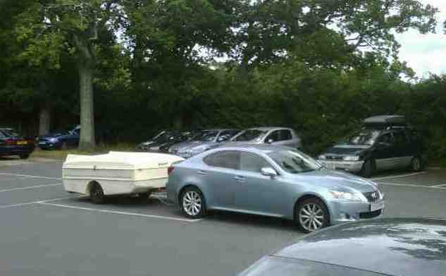

Here's the van when collected on the Isle Of Wight

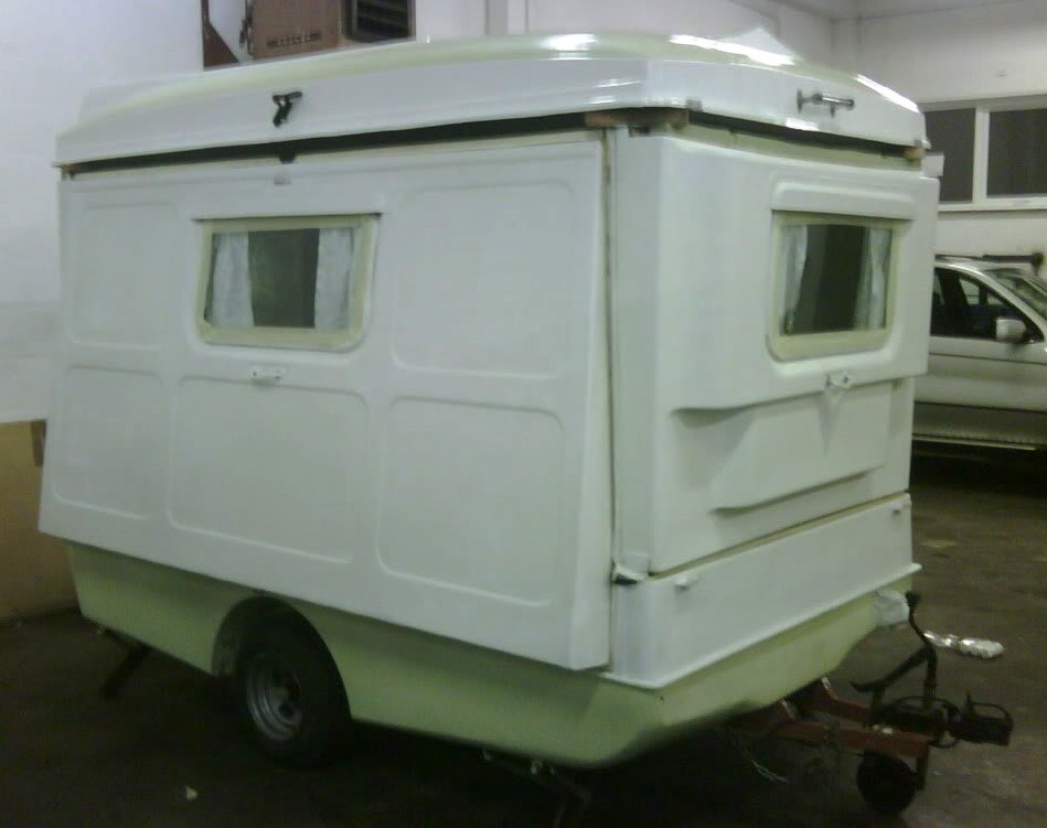

Back at home and waiting for a few gel coat repairs to the roof where it had started to craze.

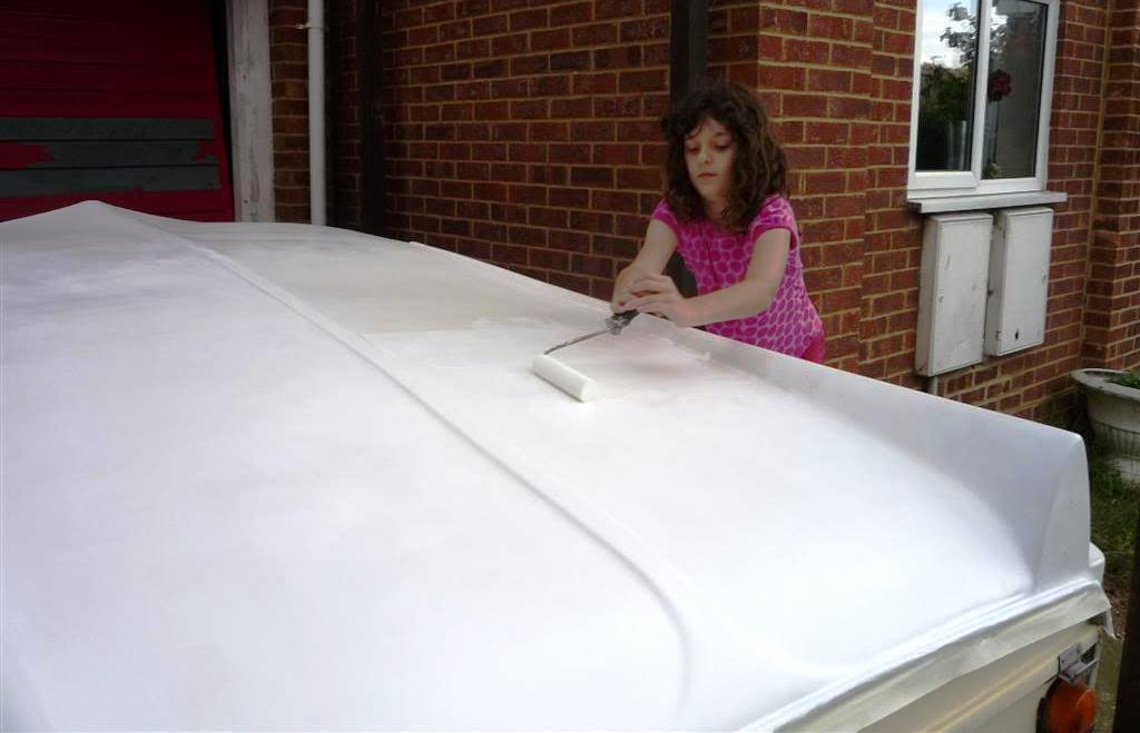

Undercoat (Crown X-treme Grip primer) being applied by child labour. :thumbup:

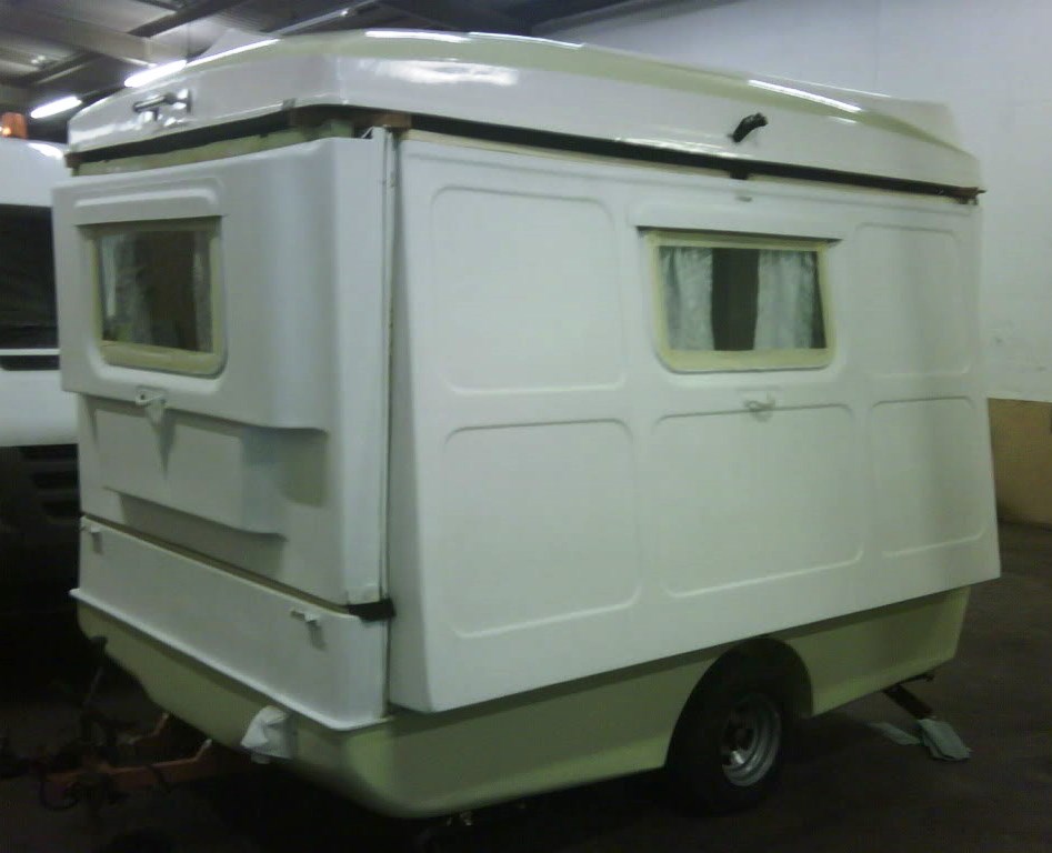

Top coat applied, to match car colour, with fins masked off.
Fins now painted.

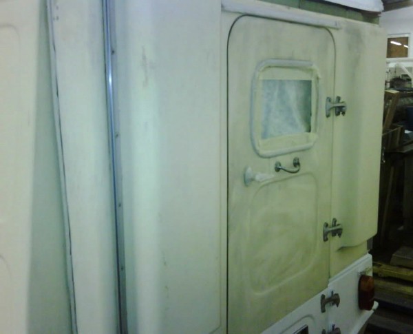

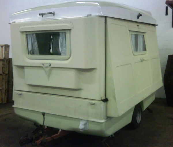

Ok, so after a lull and snowy weather I got stuck in again yesterday, in a nice big dry, heated workshop.
Masked up the windows and parts of the handles, and put on the primer coat.
Gloss coat later today.
