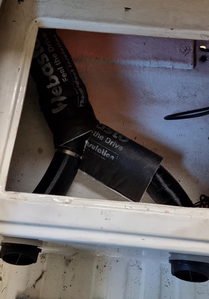

3. Bring the heat inside. I bought a 90 elbow with an 80mm internal diameter which fitted over the hot air outlet and attached the heater hose to it, wrapping the join area in motorcycle exhaust wrap to give it some strength and keep the hot bits from contacting the portafold walls. A cheap set of hole-saws from an online marketplace was perfect for this and the other holes I needed inside:
On the inside, I insulated the first part of the pipe (as it's still quite warm) and boxed in the remainder, so that it doesn't get squashed when we stow things in the centre forward cubby hole:
